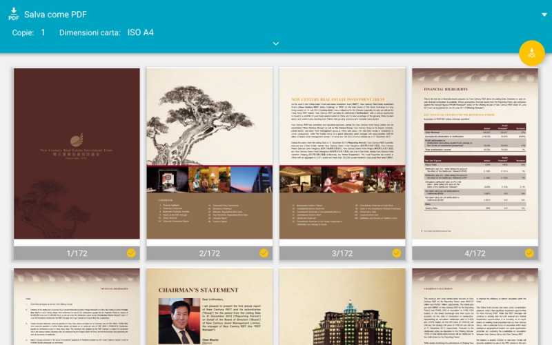

I see your log: as you can read there are any reference to RadaeePDF call. All the log are from Android framework and Android native call.
One more note: better looking at some devices we've found that Motorola X (Android 5) and Samsung TabS (Android 6) are rendering the first page in the wrong way.
We've tried also printing with Acrobat on both devices and we was getting the same issue.
One more note: Android PDF printing engine isn't able to print annotations applied to pages.

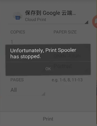

Hello
My device android version is 4.4.2
I upload the video for crash.
Video
The topic has been locked.
convert pdf to image and print issue 9 years 5 months ago #11962
We couldn't replicate your issue on a simulator of 4.4.2, but as seen from your video, it's a Spooler issue (not related to the library)
and it seems to be common productforums.google.com/forum/#!topic/chrome/E3J8Cl5Dq0U

Thanks a lot. The problem has solved.
