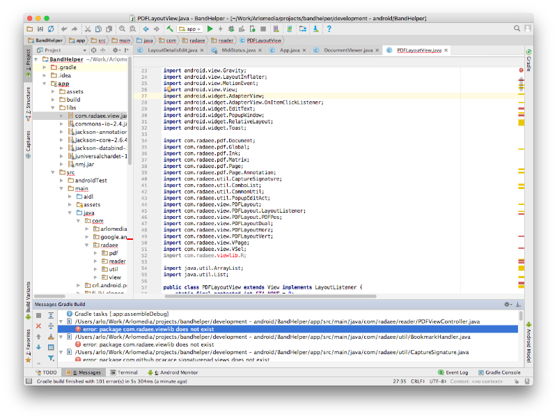

I just added the jar file -- I didn't have that before because I thought it wasn't needed with the source code installed -- but the problem is the same. The build error says "package com.radaee.viewlib doesn't exist." I'm attaching a screen shot.
I've added all the Java classes from ViewLib/source/main/java, the libraries from ViewLib/source/main/jniLibs and the jar file from ViewLib/libs. It seems like I'm missing a file, but I searched 3.15 download and don't see any files named viewlib.
Migrate to 3.0? 7 years 11 months ago #13704
as written here www.radaeepdf.com/support/knowledge-base?view=kb&kbartid=2 if you have the source code, you have to remove the jar and its references.
Regarding the screenshot, you have to remove the line 52, after that, Android Studio will import the R file automatically and if you don't have bad xml, res or other the app will run.
