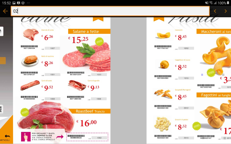

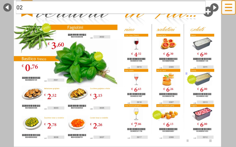

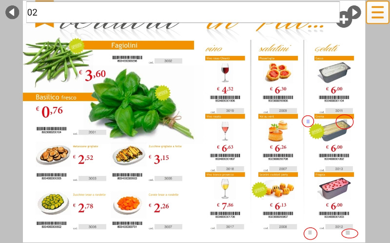

Hi Luca,
as you can see in the image attached the pdf page doesn't change correctly
and previously selections when I search next result remain active.
I simply use com.radaee.reader.PDFGLLayoutView with ILayoutView implementation of search calling:
PDFFindStart("02", false, false)
PDFFind(1)
Ps Managed on PdfViewDual in the same way works fine (But PdfViewDual is deprecated)
Tommaso Honoré

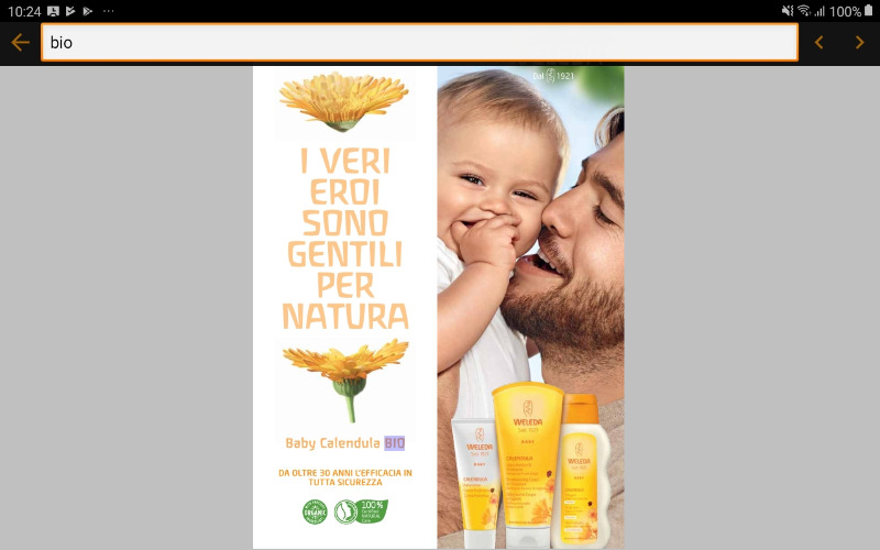

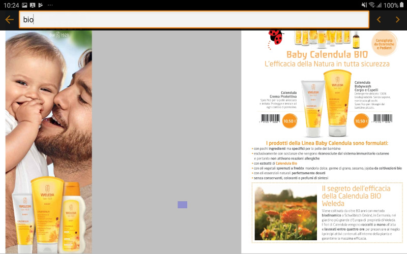

Hi Luca,
I've the same issue with all pdf file.
Have you try to use right arrow to search for next result on a pdf drawed in landscape? global.SetField("def_view", 6)
Seems that work only first time and on serchedittext_ReturnClick but not on next previous arrow
