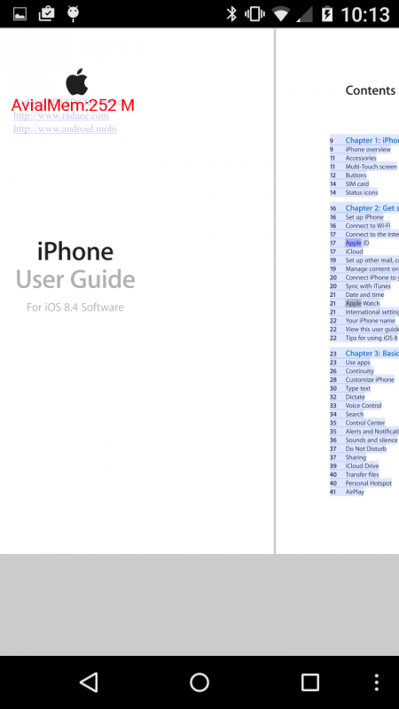

we are integrating your library in our Android app. However, we have noticed some problems during a search.
Here is the problem:

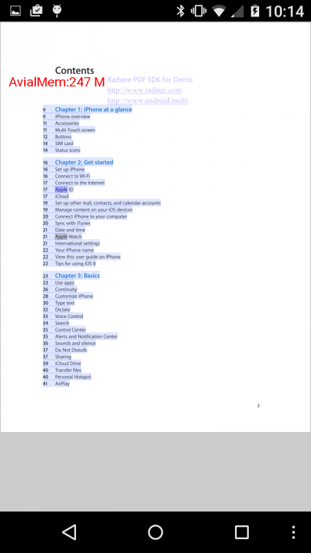

As you can see, the page containing the search results is not properly centered, while the right result should be as follows:

we've just tried with the latest version of the library (v3.6.1) just downloaded from your site. Then we've made the change:
Then we have followed all the steps we have indicated above in the ticket. However, the problem continues to persist. Can you help us?
