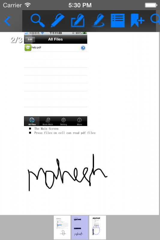

if am i doing wrong please suggest me.i want to know annotation frame area. actually i want to capture frame (annotation area) so i will convert into image. please help on this asap.
i have print rect this gives me
m_annot_rect = {
left = 103.89996
top = 124.48999
right = 402.49994
bottom = 267.70996
please look mahesh (ink annotation) area. this does not match with area
