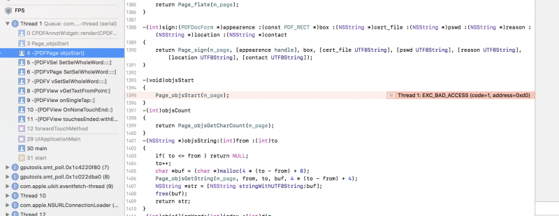

I am using RadaeePDF to open and edit files in cordova app. It was working fine before. But the latest fix version of RadaeePDF, causes the app to crash when we try to edit the pdf form.
I have attached the PDF file and the error for iOS, but this happens for both Android and iOS. I have the latest version of RadaeePDF plugin installed

Also, I forgot to mention one thing, the plugin crashes only after clicking on first page of the pdf that I have uploaded before. It works fine on second page. It might help you to regenerate the issue.

PDF edit not working 8 years 8 months ago #13159
Dear Pooja,
We've updated the plugin with the fix for Android, please check it and give us your feedback.
If it's working, we will proceed with fixing also the iOS version.
PDF edit not working 8 years 7 months ago #13175
Dear Pooja,
we've updated also the iOS plugin, please check it and give us your feedback.
