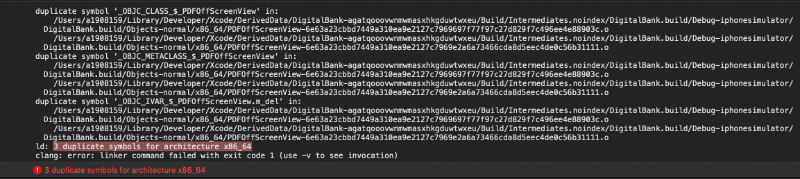

Hi digibank,
Could you please share us the whole compiling error?

Right now Radaee Swift is only available in project version already uploaded, aligned with Radaee 3.7x demo.
Thank you for your feedback, we'll solve this issue and update documentation.
To solve it you should delete duplicate symbols: just remove reference or move to trash the PDFOffScreen class situated in Radaee/include/PDFViewer. Then you should have the same class not duplicated, situated in Radaee/include/PDFViewer/PDFView.
