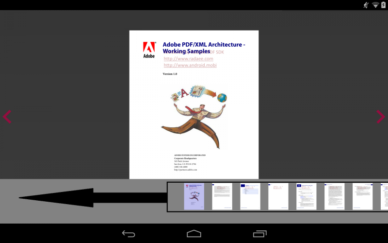

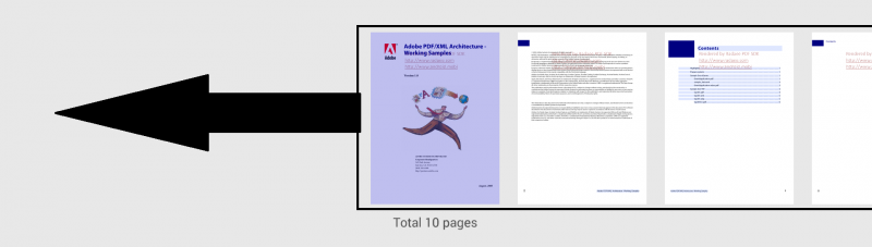

I am using "Radaee-PDFViewer2.9.10-Lib.jar" for my android project.
I want to know how to make the preview PDF start on the left hand side,not middle.
[Class PDFViewThumb]
