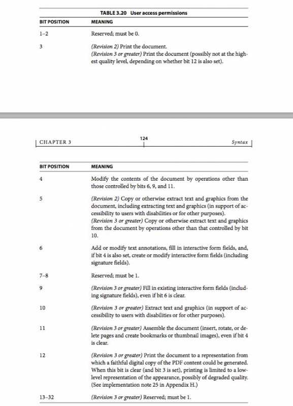

Explanation of EncryptAs() 10 years 8 months ago #9336
user password: is the public password (shared with authorized users). It's sufficient to open the file with applied permission mask set.
owner password: is the password that allow opening the file without any restriction from the permission mask.
permission mask is defined as per below image: the table has been taken from pdf_reference_1-7.pdf, the official PDF definition from Adobe.
encryption method: always equal to 4. RadaeePDF actually support only AES encrypted output.
id is something like the encryption seed or salt is some other encryption scheme. That id is a reserved code that make password stronger.
