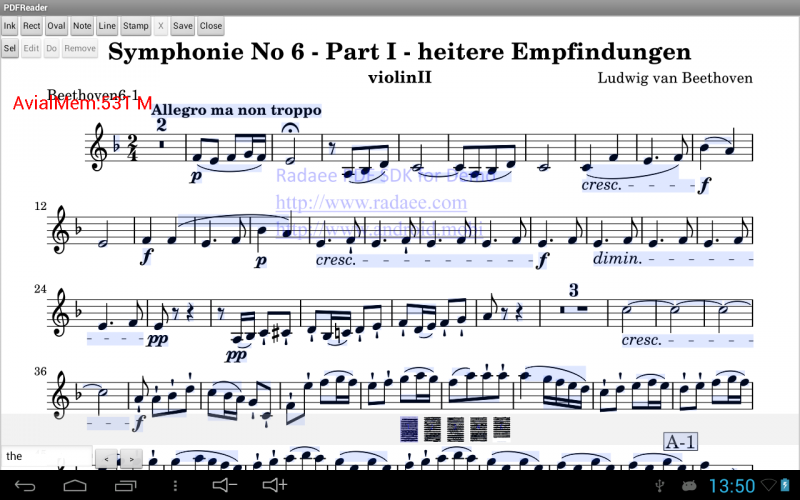

We have PDF files with lots of hyperlinks in them. The library seems to show those in light blue. See attachment.
How can we avoid that these get shown as we don;t allow someone to click/tap on them anyway.

you can use annotation.RemoveFromPage() to remove annotation.
You should re-render page to display modified data.
This method is valid in professional or premium version.

So you mean that before displaying we would have to walk through the document, and remove all hyperlink "annotations". That's annoying.
I'd rather have a global option to not display these (or even all) annotations (we handle annotations in a different layer anyway, not inside the PDF).

if you don't want to remove them, you can set transparent background color to the links.
You have to:
setAnnotTransparency(0x00000000);
in default_config() method of Global class.
