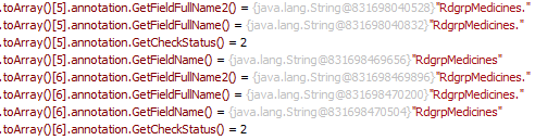

sure! And yes, we are trying this with several PDFs. What we are having is a list of fields. In the end, there is also 1 RadioGroup defined in the PDF. This RadioGroup has 2 RadioButtons.
What we want to have now is 2 objects with the different names. This can either be GroupName.ButtonName or just ButtonName.
What we get is this, when using the methods:
What we actually want to have is like:
RdpgrpMedicines.Yes
RdgrpMedicines.No
So that we can differ between those :) I hope you got the thing now :S
