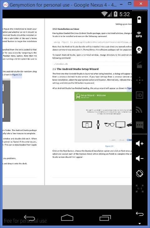

For several days I am struggling with the problem that a page of pdf document is not centered after device orientation change. Moreover, after several rotations of device I'm on a different page than I was at the beginning.
Anyone have any idea how to solve it issue?
I an mot using PDFLayoutView, just RelativeLayout for PDFReader instance.

Thank you for yours answers but i don't want to change all my class because of that issue (unless it turns out necessary). My initiation of PDFReader is shown below. I don't manage device rotation in any way (in this activity). I tried to use overrided method onConfigurationChanged(), but with no result.
private void postInit() {
		gestureDetector = new GestureDetector(this, new DoubleTapListener(this));
		ViewGroup container = (ViewGroup) findViewById(R.id.pdf_container);
		m_vPDF = new PDFReader(this, null);
		m_vPDF.PDFOpen(m_doc, false, this);
		m_vPDF.setGestureDetector(gestureDetector);
		container.removeAllViews();
		container.addView(m_vPDF);
Thanks in advance for any idea to solve this mystery.
