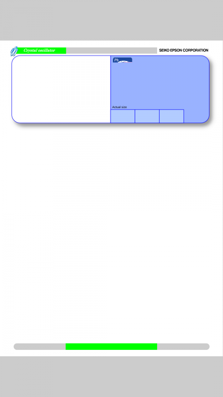

One more question:
some pdf can not be rendered normally , pics can not be rendered.
(plz check the attachment pic )
Hope for your reply !!!!!!

Please check the attachments below
sekorm.pdf for the scale value problem;
EPSON.pdf for the render problem.
