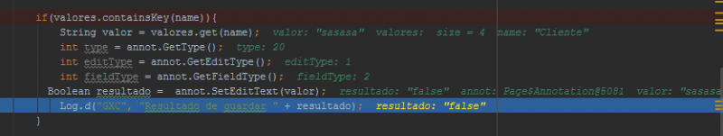

Hi
I´m respecting the fields format. Here is an example. It shows field type 2 (text field),l edittype 1 (single line) and I´m trying to set a plaint text value. SetEditText is returning false. I have previously called init and activated my premium license (it returns ok).. Whats the problem? CanSave() also returns true.
