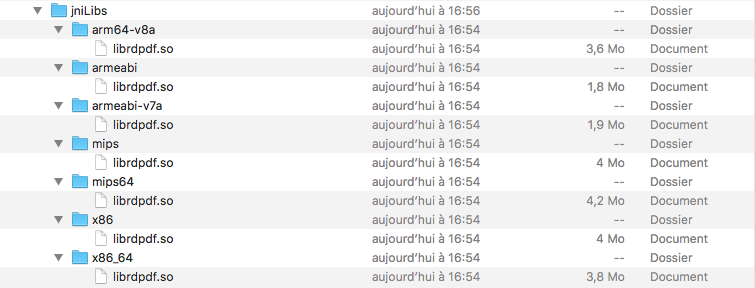

I would like to reduce Radaee Pdf reader size.
In your project, I found 7 librdpdf.so (4Mb)
Is it possible to remove some .so to reduce size project?

Yes, less adopted architectures are:
- mips: really poor diffusion
- x86: available on last generation of Asus and other chinese an taiwanese devices
- arm64: really improve performances over the 32bit version but you're allowed to remove it as the system will fallback on 32bit without issue
