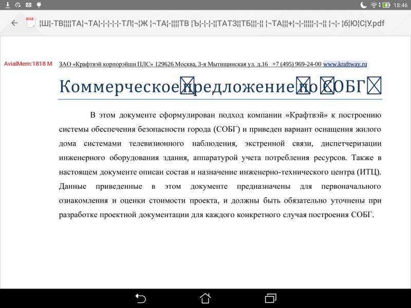

I updated to 3.9 version and I have some trouble with the rendering of this pdf file

, this is the result of rendering. You can see some square symbols which were added to pdf document. Note: the issue is reproducible only on devices with X86 architecture.
Could you help me with this issue?

We are still trying to understand the cause of this issue, the problem is we wasn't able to reproduce it on the simulator of x86..and on the devices we have it renders correctly.
Some square symbols are added to pdf document 9 years 7 months ago #11511
The issue is because of the fallback font, that is not complete (does not contain all the characters).
Please follow the steps mentioned in www.radaeepdf.com/support/knowledge-base?view=kb&kbartid=25
