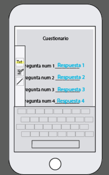

Hello I mean the following:
I would like to add text over a pdf, I have a book in pdf which contains some questions that I want to answer through the application
Step 1: select the writing tool
Step 2: write the answer
Step 3: move it text if necessary, rearrange or remove it
Is it possible to do this?

This can be achieved using Editbox annotation, that can be added using Page.AddAnnotEditbox
Repositioned using Annotation.SetRect
Removed using Annotation.RemoveFromPage
For more details, you can check How to add an Edit Text annotation (Android)

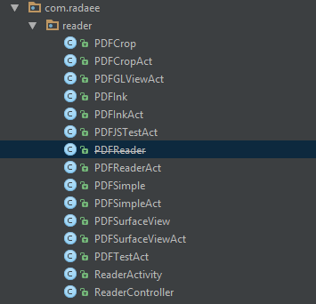

Hello how can I run the PDFReader activity , appears as deprecated
Add text, Android 8 years 10 months ago #12339
Yes, PDFReader is deprecated. We recommend to use RDPDFReader instead (PDFLayout instead of PDFReader) as it's better performance wise.
You need to run the RDPDFReader module (com.radaee.reader.PDFViewAct)
