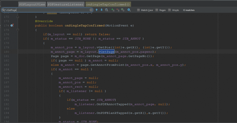

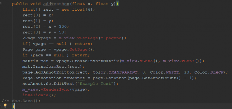

I read various topics from knowledge for add image, add annotation and others solutions and all have problems with library because they do not have variable or others, see images added.
First i think i have a old version library then i download latest version and problem is same.
I have a m_view on my sample, and I have a m_view on your sample. That's confused for me, I do not have security if you have sample updated. I've latest library version (3.14).

Now the KB is updated, to add the annotation you can add your method in PDFLayoutView.
