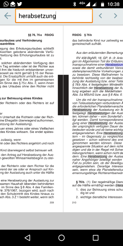

When doing a search on Android, half pages are displayed based on the position of the found search term. Please have a look at the screenshot. How can this be fixed. Thanks for your help!

If you have a professional or premium license, you can download the source code of the com.radaee.view.jar (if you have not done that yet) and add the following code at the end of the method PDFLayout.vFindGoto
m_scroller.setFinalX(x);
m_scroller.setFinalY(y);
if(this instanceof PDFLayoutDual)vGotoPage(pg);
To download the jar's source code please check Where can I get the source code of the Android SDK?
Note: this fix will be added to the next beta that should be released by tomorrow.
