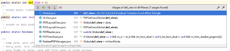

Seems that after the integration, this variable is being set to 4 or 6 (dual mode) somewhere.
These are all the usages of def_view in the demo project
So in which class are you referring to it (PDFReader, PDFLayoutView or GLView)?
