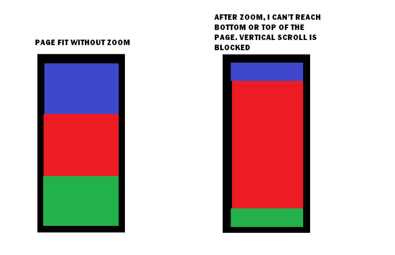

What I mean is that if I zoom in from the center of the page I can't reach bottom or top of that page by scrolling up or down. It seems like scrolling vertically(using different page size flag) is blocked by radaae lib.

Vertical Scroll after zoom using diferentes page size flag 6 years 7 months ago #14599
can you attach screen-hot to better explain this issue?
do you mean in different height of 2 page in screen, when zoom in very large size, the lower height page can't see on screen?

I added an attachment to help understand what I'm saying. I do not use opengl layout, I'm using pdfLayout.
This strange behavior only happens with different_page_size flag true, if I use the lib without this flag, the vertical move happens normally, that is, I zoom in from center of the page then I scroll the screen top or bottom to reach the start or the end of the page.
Using different_page_size this do not happen. After zoom, my vertical move is blocked, I still can scroll horizontally but not vertically.
