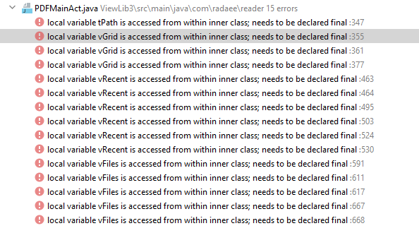

After I downloaded the new version with the checkbox fix (3.65.6), I can't compile my project.
A lot of 'local variable [variable] is accessed from within inner class; needs to be declared final' started to pop up. If I try to change the variable to `final`, more errors with
the same message in other classes appear, and so forth.
Can you guys check if this version is ok? Comparing to my current local version, those properties and variables are declared final in my currento ViewLib.
Erros while trying to update to version 3.65.6 4 years 7 months ago #15660
dear user:
this issue shall relate to java version.
compiling on our side are all OK.
if you are still facing this issue, please declare tPath/vGrid/vRecent/vFiles as class member of PDFMainAct class.

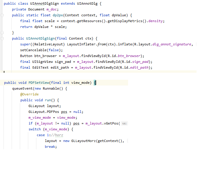

Erros while trying to update to version 3.65.6 4 years 7 months ago #15664
  • devit9ar
  • devit9ar's Avatar Topic Author
  • Posts: 35
I actually tried to use the same Java version as yours(mine was oracle jdk 8), just out of curiosity. It didn't work.
The compiler still complains a lot about those inner classes access.
There's a printscreen of the same code in an older version. It used to be different.
There's a lot of breaking changes.
I need some support on that. We need to publish the apk with the checkbox correction.
