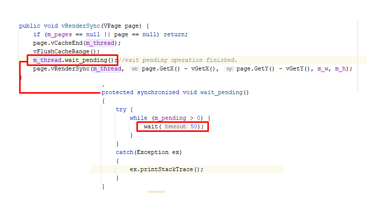

Hello Radaee.
Sometimes on some devices there is a problem: A / libc: Fatal signal 11 (SIGSEGV), code 1, fault addr 0x8 in tid 14961 (FinalizerDaemon) and the application is reloaded. The crash location was not indicated in the tracing, but after tracing, the place where it is called was found: class VThread method wait_pending () -> wait (50). Tell me how you can solve this problem or what could it be connected with? Thank you
Fatal signal 11 (SIGSEGV) 4 years 6 months ago #15684
i'm afraid not this code cause error.
maybe error generated in other thread.
plz try attached libraries.
