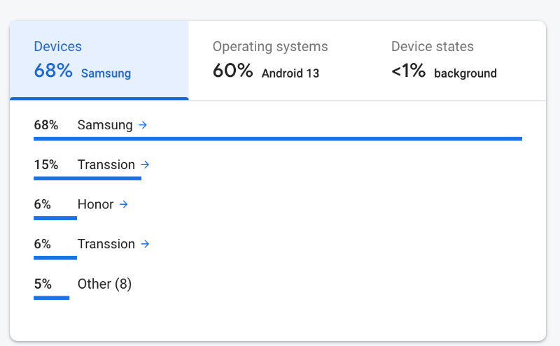

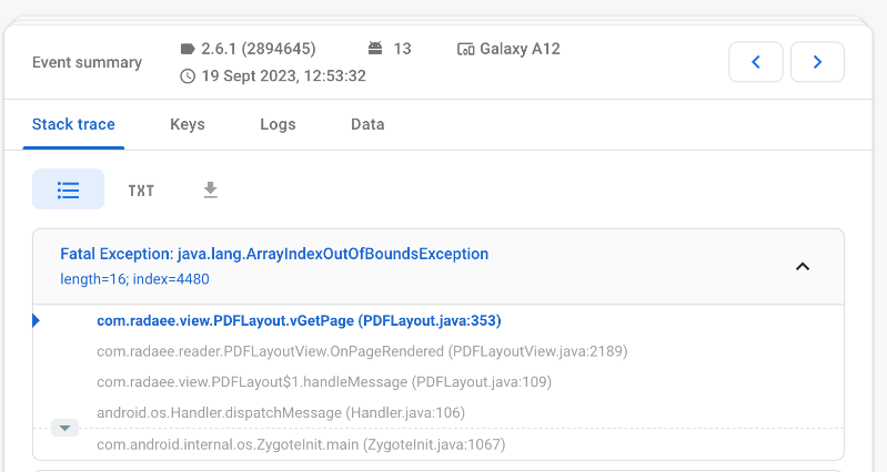

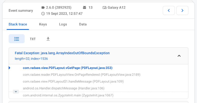

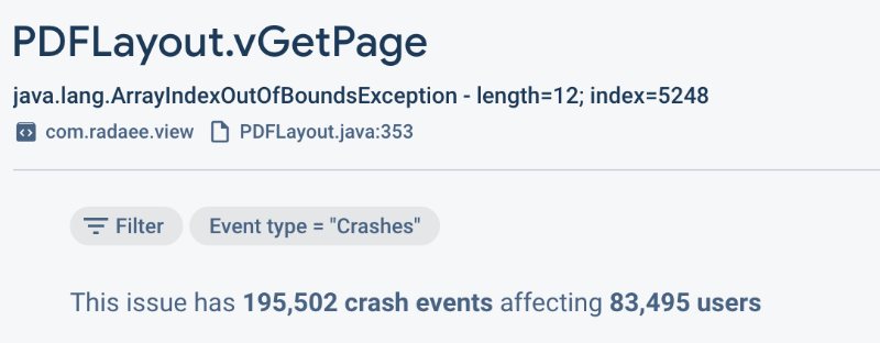

Hello guys,
I would like to highlight that this issue is the main one right now with Radaee SDK.
We are considering to revert to previous version, since our crashlytics hits new records every day as users update to a new version of our app (which has Radaee Master SDK under the hood).
Can we have a call since situation gets worse? (note that only 25% of users agreed on providing crashlytics to us, so you can multiple the numbers by 4 at least)
Typical stack trace is attached.
