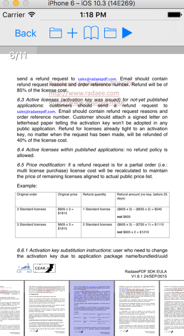

Yes, it shows file. And Radaee navigation bar exists too - see attach..

PS. I have activated license. Now Search button exists in Navbar, and controls looks bit other. So question 3) has been closed.
