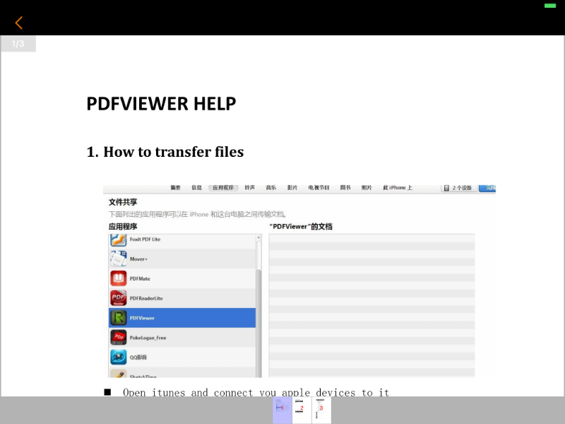

Hi Robert,
Using Radaee.setToolbarEnabled method with last RadaeePDF Cordova's plugin downloaded from GitHub you should have all buttons removed except back button on
RadaeePDFPlugin.setToolbarEnabled(
            enabled: false
        function (message) {
            console.log("Success: " + message);
        function (err) {
            console.log("Failure: " + err);
and you should have all buttons enabled with
            enabled: true
        function (err) {
Here's some screenshots

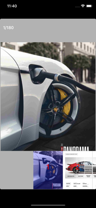

Just a note... when I run on iOS, the entire upper toolbar is not visible.
When I call this function, that I wrapped in a 'about to start' and 'done' console logging before and after the line, I do not see any logging from the message/err calls in the function line. I do see the 'success' message from the activating call right before it. It almost seems like the function is not being processed.

here is a screen grab after the open

I tried setting view mode 6 and thumb 150 height and also opening PDF from URL with RadaeePDF Cordova's demo version but I still have no problems about enable/disable toolbar, also with iPhone 11 simulator
I suggest you to try with demo version and start your project based on it.
Then if you still have some problems, if you send us your project we could try to see what's wrong.
