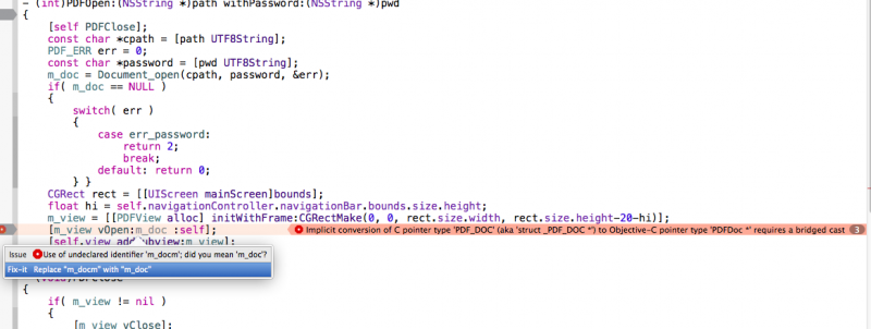

Hi
i have used your sdk. when i integrate your sdk from your given document. this gives me error on that line.
[m_view vOpen:m_doc: self]; in this method - (int)PDFOpen:(NSString *)path withPassword:(NSString *)pwd.i have attach screeshot with that.
or i have create all annotation tool bar from my self with all annotation tool or you have to provide annotation tool bar like other library.is notes feature available in your library . can we get bezier path from freehand drawing.
Annotation Tool Bar And Notes annotation feature 11 years 11 months ago #6779
you had mixed old codes and new codes.
the new codes: Document is a obj-c class, not C pointer.

Annotation Tool Bar And Notes annotation feature 11 years 11 months ago #6784
the new Document class:
PDFDoc doc = [PDFDoc alloc] init];
[doc open:pathname];
PFView view = [[PDFView alloc] initWithFrame:rect];
[view vOpen:doc.....];
view.vClose();
[doc close];

Annotation Tool Bar And Notes annotation feature 11 years 11 months ago #6785
and add PDFObjc.h and PDFObjc.m to your project.
