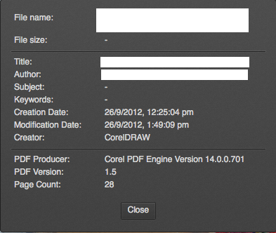

I observed one crash on page_render method for specific pdf file of properties on ios.
the pdf file having following properties
Creater : CorelDRAW
PDF Producer: Corel PDF Engine Version 14.0.0.701
PDF Version : 1.5
and one more thing to discuss that following pdf file of properties is redering properly there is no problem with this kind of pdf file
Creator : CorelDRAW Version 12.0
PDF Producer: Corel PDF Engine Version 1.0.0.458
PDF Version : 1.3
