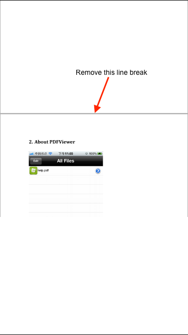

Hi all
I want to remove line break between pages in pdf file as the image is attached
How must i do?
Thank!
How to remove line breaking between pages 10 years 5 months ago #10297
you can set the gap from two pages when you call [PDFV vOpen] method in PDFView class.
In demo project you can find it at line 113:
[m_view vOpen:doc :4 :self: &tback];
The second parameter is the gap and you can set it to 0 to remove the line break.
