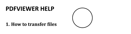

Note disappears on change of Color of note 9 years 11 months ago #10959
  • Yugandhara
  • Yugandhara's Avatar Topic Author
  • Posts: 18
when i change the color of the note using the method setFillColor:colorCode
and then refresh the page using RenderPrepare and RenderSync methods, my note disappears for some color codes such as 55000,20000,60000.
Note disappears on change of Color of note 9 years 11 months ago #10960
normally we use hexadecimal notation as 0xFF00D6D8 to set color, as we can manage the opacity and RGB channels easier.
if you try to convert your int value 55000 to hexadecimal notation, you'll get 0xD6D8, that is equal to 0x0000D6D8.
With 0x0000D6D8 the opacity value is 0 and you won't see the color set with setFillColor.
I think that the correct value you're trying to set is 0xFF00D6D8 (4278245080 in int notation).
I suggest to use the hexadecimal notation to set colors (0xAARRGGBB)

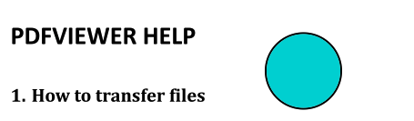

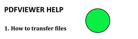

Note disappears on change of Color of note 9 years 11 months ago #10978
I checked to change the fill color of the same annot fist with
[m_annot setFillColor:4278250080];
then with
[m_annot setFillColor:4278245080];
the results are in the attachments
