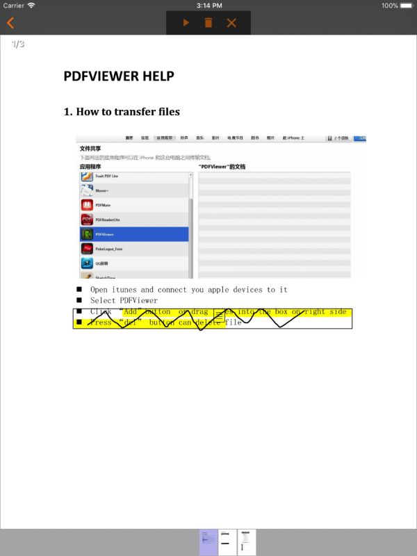

1) I'm adding an highlight annotation and then I'm selecting the text and adding a text Annotation.
Now I need to delete the text annotation, but it always selects the highlight annotation.
2)The next case is I'm adding highlight annotation and over that I'm adding an ink annotation, but within the area occupied by the highlight annotation.
Now I need to select ink annotation, but it selects the highlight annotation always.
I have attached the screenshot of, how I had added annotations in my PDF.
Then, How to disable move for annotations?

I've done some tests and I always delete successfully the text annotation above highlight text. With the last version of library if I tap on text annot it doesn't select the highlight annotation.
If you want to lock a specific type of annotation you could use setLocked(BOOL) method:
[anyAnnot setLocked:YES];
About the area occupied by highlight annotation that does not let you select ink annotation in the same area I need some time so I can give you an exhaustive answer.

In conclusion, on touch event calls
PDF_ANNOT Page_getAnnotFromPoint(PDF_PAGE page, float x, float y);
to get the annotation using touch coordinates and this is the default behaviour.
You can get all annotations with touch point inside annot_Rect and decide which annot take using annotations' index;
In your case you could get the last added annotation using:
Page_getAnnot(page, Page_getAnnotCount() - 1);
I reccomend you to take a look in PDFIOS.h to better understand all these methods.
