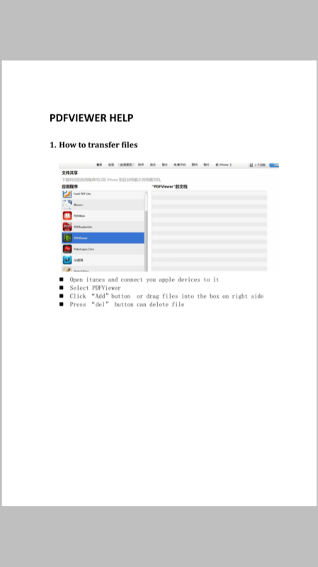

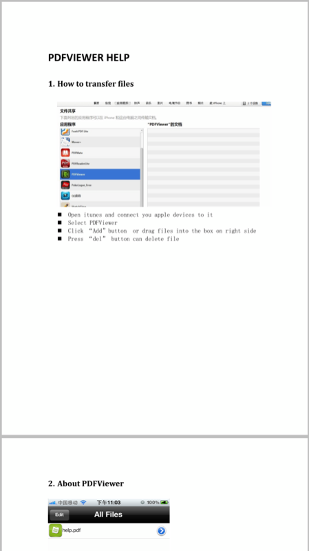

But I need vertical paging with every page of pdf needs to display in different different page. But here, second page of pdf started in first page of device.
I need every pdf's page needs to display in separate page.
Check my attachment.
- I need like my 1st attachment (IMG_6234.PNG)
- But currently its displaying as 2nd attachment.
Please help me to achieve this.

Vertical paging - Single Page Mode in iOS 5 years 11 months ago #15044
You could try changing this code:
- in RDVLayout, ProLayout method of RDVLayoutVert change the default implementation of the switch(m_align) in this way:
default:
                int pw = [m_doc pageWidth:pageno] * m_scales[pageno];
                int ph = [m_doc pageHeight:pageno] * m_scales[pageno];
                int ch = (ph + m_page_gap < m_h) ? m_h : ph + m_page_gap;
                RDVPage *vp = (RDVPage *)[m_pages objectAtIndex:pageno];
                [vp vLayout:(m_docw - pw) >> 1 :docy + (ch - ph) / 2 :m_scales[pageno] :true];
                docy += ch;
                break;
- add vGotoPage in RDVLayoutVert implementation in this way:
-(void)vGotoPage:(int)pageno
    RDVPos pos;
    pos.pdfx = 0;
    pos.pdfy = [m_doc pageHeight:pageno];
    pos.pageno = pageno;
    [self vSetPos:m_page_gap / 2 :(m_h - ph) / 2 :&pos];
This is a sample implementation and not supported in demo project.
We don't know if it works for pdf with particular sizes and you should handle these cases.
Last edit: by emanuele.
