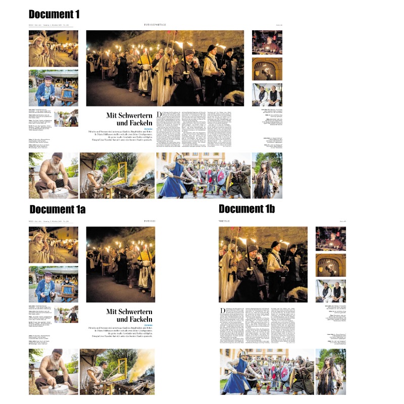

here you can see what I mean. I got one doublesized pdf-page and I want to cut it, so it has the same size like all the other pages in my document.
I don't care about size (yet).
To your suggestions:
As this is one Document, with one page, I can not importPage 1. There is only 1 pagecount.
Thats why I tried with ChangePageRect, but this only shows the left part of Document1, no matter if I crop from left or right.
Change visible Part of PDF with ChangePageRect 6 years 8 months ago #14666
You can achieve that by changing the MediaBox advanced property. please check Change page size using Advanced properties for an example
