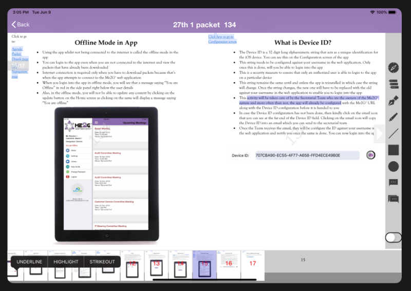

Dear Team,
When we select text in pdf underline,strikeout and highlight option appears below in the thumbnail screen not above the selected text.In iOS 12 this problem appears below is the attached screenshot.

Hi Team,
But my question is whenever i selected text in double page mode my hightlight underline option comes down not where i have selected the text can you please check once in iOS 12 version of ipad and works fine with the higher version of iOS release.

Hi Team,
See first go to double page mode and now you have to select the text on page which you have not selected if you see below on thumbnail suppose the page which is selected is page 2 and now have to select the text on page 1 and then you see the menu where it comes.
