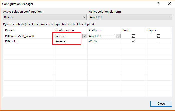

Make sure that you are using the release builds with both projects, check the screenshot..
You can hit this error if your build runs the WACK tools against DEBUG builds as a custom step or you don’t have the .NET Native toolchain enabled for your RELEASE builds.
If you still have problems, can you send us more details about your configurations?
