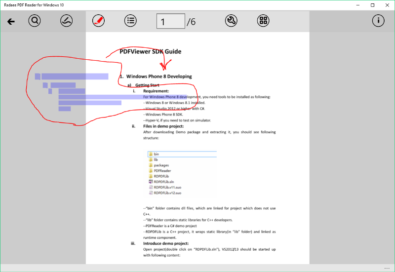

How can I decrease the minimum zoom level when in PDFVertMode?
I tried decreasing the minimum zoom level on the m_scroller.minimumzoomlevel to 0.25:
m_scroller.MinZoomFactor = 0.25f;
This works well, in that it allows me to zoom out further than the widt of the page. The problem is however that when you try to make highlects the selection rectangles are not center aligned. There left property is still 2, and this causes the selection to be to the left of the actual text of the document. Please see the attached screenshot.

I attached the document again.

This obviously also affects drawing on PDF's.

The new version 1.9.43 should fix this issue.
Please check it and give us your feedback.
