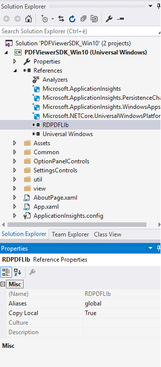

It seems like you are not correctly setting the configurations of the reference,
Make sure that for the reference RDPDFLIb , you have (Copy Local) set with true (Check the demo project for a guide)

And what are the reference properties for RDPDFLIB?

looks the same to you.

  • Posts: 5
looks the same as you.
